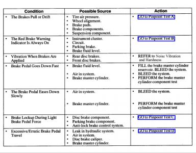

I have changed out the rotor and brake pads. The brakes work fine but I still have to push the brake pedal about halfway to the floor for a complete stop. Thank you
