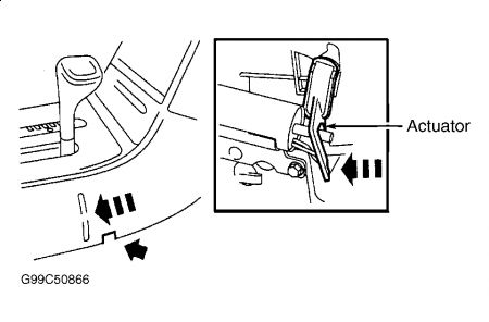

2000 Ford Mustang 6 cyl Two Wheel Drive Automatic
gear shifter stuck in park and won't budge. I think there's a fuse or something that may need replaced but have forgotten where to look. I can't find the book on it cause I jsut moved. Please help, thank you

Check fuses under dash #17-33-35 Emergency unlock use screwdriver place in slot push interlock back
https://images.2carpros.com/forum/automotive_pictures/198357_Graphic_32.jpg
