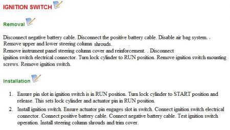

I think it is my ignition starter switch that is giving me problems. I can put my key in and try to turn it over but none of the gauges come on. I have fuel mixture gauges in my car and those are running fine since I have them going straight to my battery. I don't know what else it could be. Can it be something else, and if not where can I locate the ignition starter switch on my column?

hello and thanks for the donation is the theft system indicator light on or flashing ? may want to try a spare key. also check fuses to ignition. if all is good then switch may indeed need replacing. replacement steps are below for the ignition switch..
https://images.2carpros.com/forum/automotive_pictures/261618_Noname_1966.jpg
