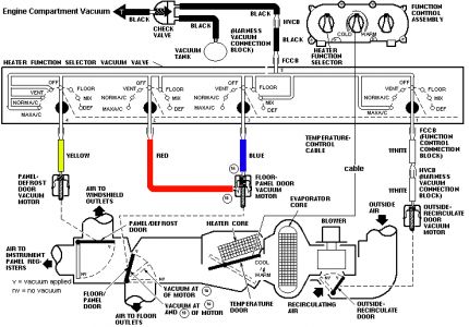

OBSESSED2
Here is the vacuum line routing diagrams and two guides that can help us. https://www.2carpros.com/articles/air-vents-stay-in-the-defrost-position and https://www.2carpros.com/articles/car-heater-not-working
https://images.2carpros.com/forum/automotive_pictures/402308_Mustang_AC_heat_vacuum_controls_3.jpg

2CARPRO JACK
  • 11,533 POSTS
That is a lack of vacuum causing that.There should be a vacuum line coming out of the firewall on the passenger side that attaches to the engine

STINGRAY53
  • 5 POSTS
thank you found it under hood Vac line disconnected\

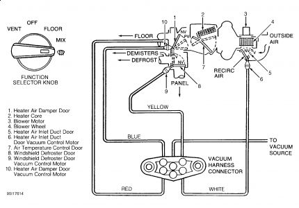

RACEFAN966
  • 5,029 POSTS
Ok lets tackle one problem at a time if you don't mind. First here is a pic of how the vacuum is routed for the heating system. Let me know how it goes and we will go from there. Once the heater is fixed then we will move to the A/C problem ok. I also need to know if this is a GT or Cobra or ? as some stuff may be different. Get back to me.
https://images.2carpros.com/forum/automotive_pictures/249564_Graphic_93.jpg
Jan 18, 2019 at 4:04 AM (Merged)
WIZZAP
  • 31 POSTS
Its a V6 also that doesnt help I need to know where the vaccum line under the hood goes the one that feeds all those lines in the pic
RACEFAN966
  • 5,029 POSTS
I don't say exactly it just say to manifold vacuum. Meaning that is has contant vacuum. If you don't find one let me know and I will check my 98 and see where it goes.
