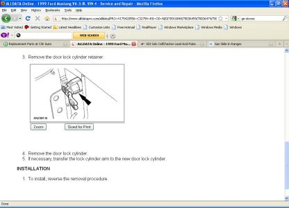

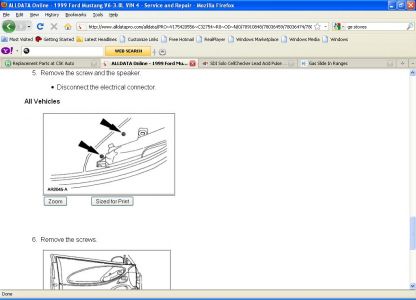

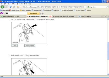

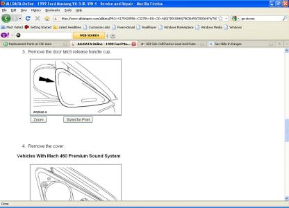

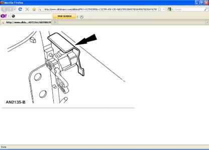

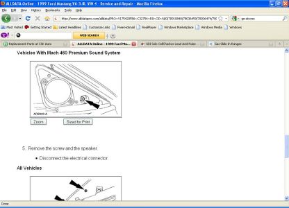

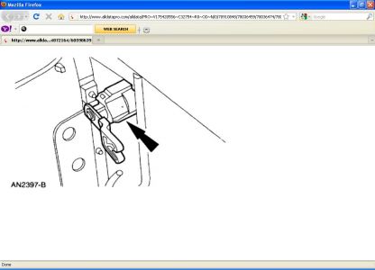

I need instruction on how to change the door lock and window switch.s. Actually the switches are OK but the screw holes where you attach the module to the door panel are broken so it falls out of the door panel!!! Raelly hard to explain. Drivers Door!

https://images.2carpros.com/forum/automotive_pictures/416332_1999_ford_mustang_door_panel_removal_part1_1.jpg
https://images.2carpros.com/forum/automotive_pictures/416332_1999_ford_mustang_door_panel_removal_part2_1.jpg
https://images.2carpros.com/forum/automotive_pictures/416332_1999_ford_mustang_door_panel_removal_part3_1.jpg
https://images.2carpros.com/forum/automotive_pictures/416332_1999_ford_mustang_door_panel_removal_part4_1.jpg
https://images.2carpros.com/forum/automotive_pictures/416332_1999_ford_mustang_door_panel_removal_part5_1.jpg
https://images.2carpros.com/forum/automotive_pictures/416332_1999_ford_mustang_door_panel_removal_part6_1.jpg
https://images.2carpros.com/forum/automotive_pictures/416332_1999_ford_mustang_door_panel_removal_part7_1.jpg
https://images.2carpros.com/forum/automotive_pictures/416332_1999_ford_mustang_door_panel_removal_part8_1.jpg
https://images.2carpros.com/forum/automotive_pictures/416332_1999_ford_mustang_door_panel_removal_part9_1.jpg
https://images.2carpros.com/forum/automotive_pictures/416332_1999_ford_mustang_door_lock_cylinder_part1_1.jpg
https://images.2carpros.com/forum/automotive_pictures/416332_1999_ford_mustang_door_lock_cylinder_part2_1.jpg
https://images.2carpros.com/forum/automotive_pictures/416332_1999_ford_mustang_door_lock_cylinder_part3_1.jpg
https://images.2carpros.com/forum/automotive_pictures/416332_1999_ford_mustang_door_lock_cylinder_part4_1.jpg
https://images.2carpros.com/forum/automotive_pictures/416332_1999_ford_mustang_door_lock_cylinder_part5_1.jpg
https://images.2carpros.com/forum/automotive_pictures/416332_1999_ford_mustang_door_lock_cylinder_part6_1.jpg
First of all thank you so much for your donation.I posted the information you needed.
