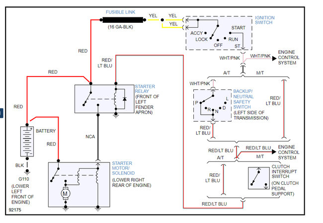

I have a 1998 Ford mustang & the solenoid needs replaced but we cant seem to find where it is so i can replace it. Its not the starter bc I had that tested.. PLEASE HELP ASAP!
Jun 24, 2010 at 3:42 PM
  • CAR REPAIR CONTRIBUTOR
  • 75,992 POSTS
The starter relay is in the engine compartment fuse box-make sure power is coming out of the ignition switch thru the transmission range sensor white and pink wire in the cranking position of the switch before you replace the starter relay

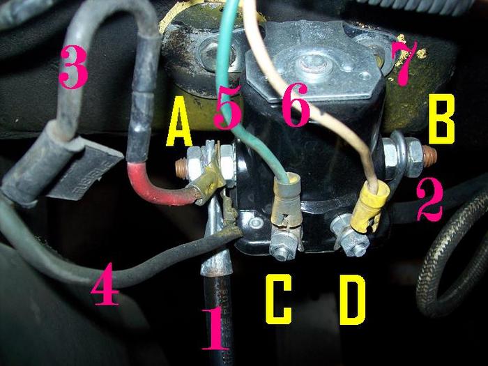

Starter solenoid wiring diagrams below.
i hope you have not blown fuses or done something bad! this is the old style ford solenoid all of the accessories go on the battery cable side with the battery cable the starter is all that is on the other big lug
"s" and "i" are all that should be left......with my info below, and a voltmeter, you may be able to find out which is "s"
"old ford type" solenoid system, your acces., may vary (this was really intended for jeep cj people!)
1) positive cable from battery
2) out to starter motor
3) on my jeep, this goes to the alternator
4) this feeds my fusebox (all of my accessories)
5) "s" wire is from key, 12v only while you are "cranking"
this wire activates the solinoid's electromagnet, which in turn, connects---a and b internally (only the 2 large gauge cables can handle the amperage the starter "pulls").
when the solenoid is activated, it throws 12v to starter using the large gauge cables (1) pos from batt--thru solinoid internal connection--(2) to the starter, while key is in "cranking" mode.
this is the total reason for a solenoid, because it would not be practical, to run the heavy cables to and from your key switch.
6)"i" wire (optional), feeds coil "full 12v", only while "cranking", after you release the key, the coil reverts back to reduced voltage, supplied by your key in the "run" position.
7) "solenoid mount" ground, unit must have a good ground (batt. to engine, engine to frame, frame to body [all must connect, somehow] )
(3 and 4, on my jeep) are fusable links, all are not marked, my #3----- is, #4----- is not....its sort of a "wire" fuse.
if they are good, tugging on them will be just like a wire, when they are "burned up", they will stretch out lke a rubber band.
if your solenoid is good---just not getting a "signal" from the key--we can test that too! (then you will know which direction to chase this problem)
"s" is the wire that activates the solenoid----we can sorta cheat it!
regardless what you do to cheat it, you are suppling 12 volts to the "s"('s) terminal on the solenoid....this is momentary as if you are cranking with the key
stay clear of moving parts!!!!!!-----in park--or emergency brake on!!!!
i prefer a "remote starter switch"
a jumper wire momentarily touched or a screwdriver touching pos battery or pos battery cable to the "s" terminal will by-pass the wire from the key
this will for sure let you know whether its a solenoid problem or a key ( ignition switch not delivering 12 volts)
this will start your rig if your key is in the "on" position
if you changed your coil and did not get the one that says, "for use with external resistor only"...you need to get that one! you have just "doubled" your resistance (w/ one with a internal resistor), and do not have enough volts to make it fire!!!! (your resistor is a "resistance wire" going to the coil already!)

It's really not all that complicated.
The battery cable attaches to the near side large post. The cable to the starter goes to the opposite large post. The ignition trigger wire pushes onto the terminal marked "S". All the remaining wires go on the battery cable side.

Ok, this is the seleniod by the battery. There are actually more than 3 wires that are connected to it.
Wire 1 positive cable from battery to large terminal closest to battery. other side or seleniod the large terminal should have all the other wires with eyelets, then inbetween the large terminals are 2 small terminals one should have an "I" and one an "S" there should be a small wire that should push on it will go on the "S" Terminal.

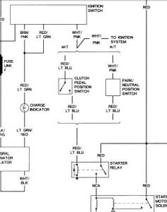

I bought a starter solenoid for my 1971 mustang. The one I bought has four connections two small ones and two large ones. I bought it with the specifications to the car 1971. The solenoid on the car has only three connectors
two large one and one small, but the car has two small wires going to the solenoid only one was connected. Please let me know what's wrong.
Oct 12, 2020 at 11:31 AM (Merged)
  • 75,992 POSTS
The two small ones should be lable S and I the S is where the ignition switch start circuit hooks up to and the I goes to the ignition bypass-which means it goes to the ignition coil positive terminal to apply full battery voltage during cranking mode-

I'm working on fixing up my 1967 mustang, and all of a sudden, it won't try to turn over when I turn the key. I can jump it from the solenoid (which I just replaced) but it won't do anything when I turn the key. Also, the fuel pump has been working great, and now all of a sudden all I see is a trickle going through the inline filter, so even when I get it it to start from the solenoid, it won't idle. There are electrical issues inside the car (none of the lights work) and also, turn signal on front passenger side on both the hood and the front of the car won't work. Could there be a short causing not only the lights, but now the starter to not work, or is that 2 separate issues? And if it's not related, do I need to replace the starter and fuel pump?
HMAC300
  • 48,601 POSTS
check to see if power is going through ignition switch to relay first it should go to one of the small wires on relay if not it may be a neutral switch. Fuel pumps can go out like yours , however check to see if there is no blockage in fuel line. take a small gas can and run hose to inlet side of pump then try pumping into jar that will tell you if pump Is good or not. some of the ignition switches would burn up behind them and ford used to sell a kit to just replace that part but I think you need round pins . I still have them in my tool box lol. as far as interior lights check your door switches they usually rotted out and wires fell off. the turn signal can be a bad bulb as well as shorted wire or t/s switch.
