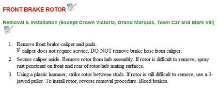

how to remove front rotors

https://images.2carpros.com/forum/automotive_pictures/261618_Noname_1923.jpg
