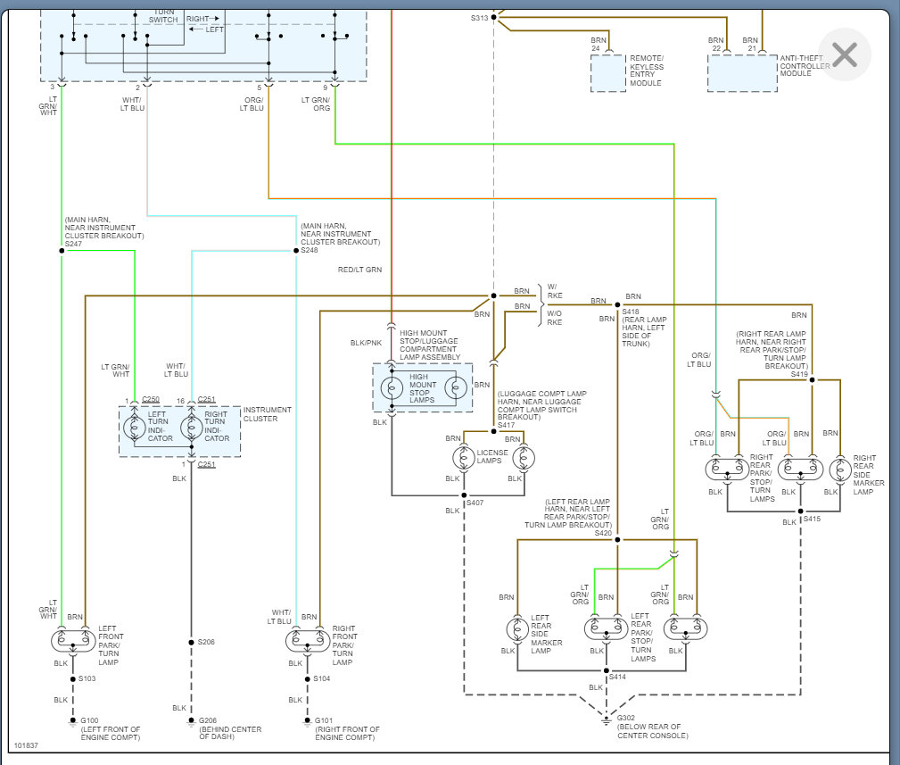

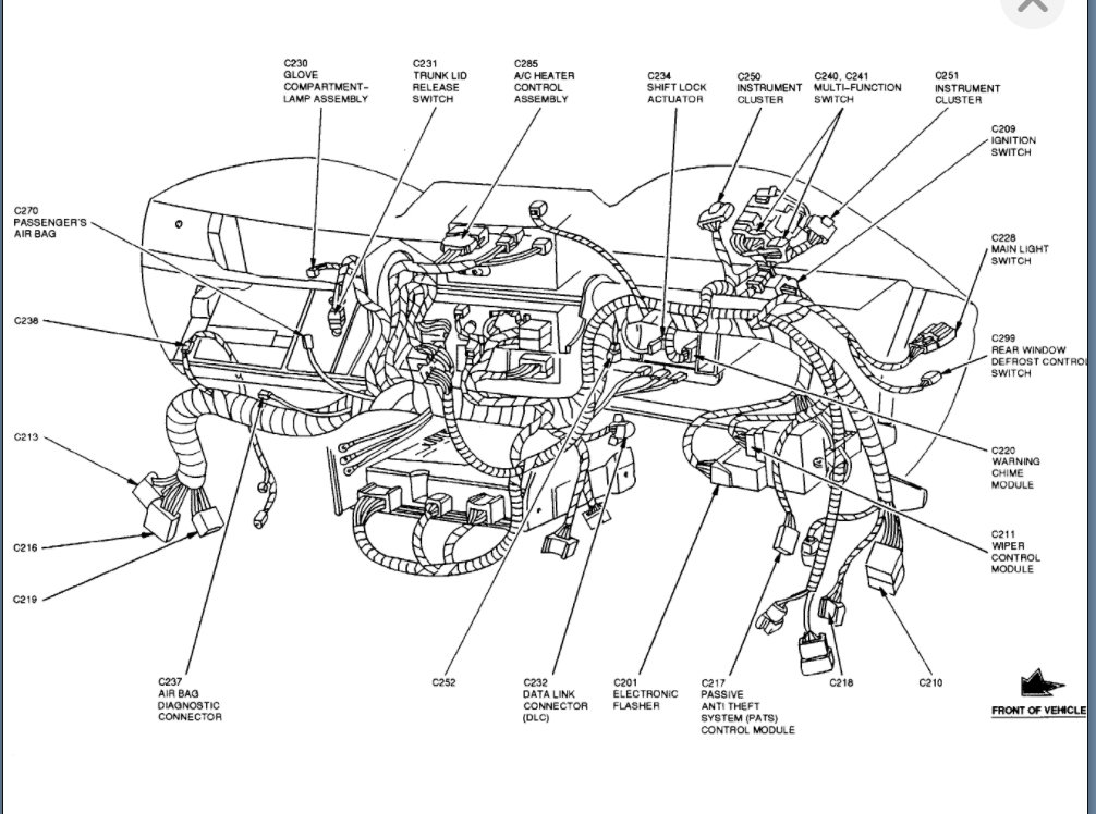

We noticed our blinker not working properly all of the time so we went to AutoZone and asked an employee what it could be. He said the flasher most likely because the hazards worked with no problem all of the time. Well we don't know where it goes??? The guy told us under the dash but we don't see any place for it. Could you help me out?

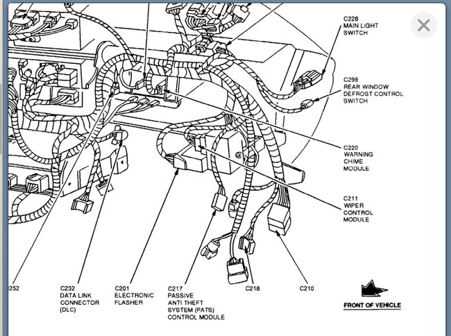

This relay is called a flasher and it is located on the back side of the IP fuse panel.

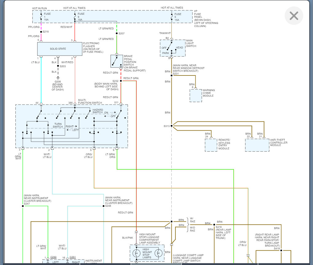

I am attaching the info below on where this is located but I am also attaching the wiring diagram.
I would suggest we check the voltage coming from the switch and if there is none then the flasher is the likely issue.
