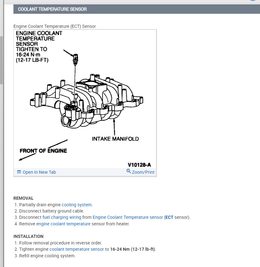

This could be related so we need to start by checking the codes and find out what is there.
If this is a coolant temperature sensor, then it will have the fan on high just to be sure the engine doesn't overheat. So here is a guide that will help with checking the codes:
The steering issue will not be related but depending on what codes are there will have a better direction on where to go.
I am attaching the info from the manual on how to replace the ECT as I suspect we have an issue related to it, but we need to start with checking the codes so that we can do the proper testing.
Thanks
