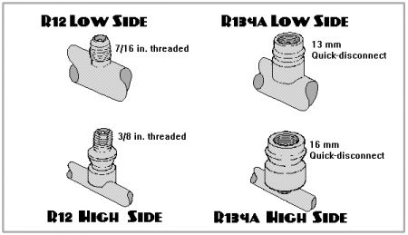

Where is it exactly that I put the air conditioning recharging fluid?

On the 13mm fitting this is the low side
https://images.2carpros.com/forum/automotive_pictures/12900_ac_service_fittings_27.jpg
