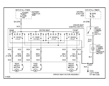

The driver power seat doesn't work. There is one wire disconnected on the switch and I don't know where it goes. Is there a wire running list for this power seat switch

check fuses and relays
https://images.2carpros.com/forum/automotive_pictures/99387_Graphic1_88.jpg
