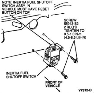

where can i find my switch
Mar 17, 2010 at 4:33 PM
  • 75,992 POSTS
If you're looking for the inertia fuel shutoff switch see below:
https://images.2carpros.com/forum/automotive_pictures/12900_is_1.jpg
The Inertia Fuel Shutoff switch is located on the LH side lower back panel in the luggage compartment.
