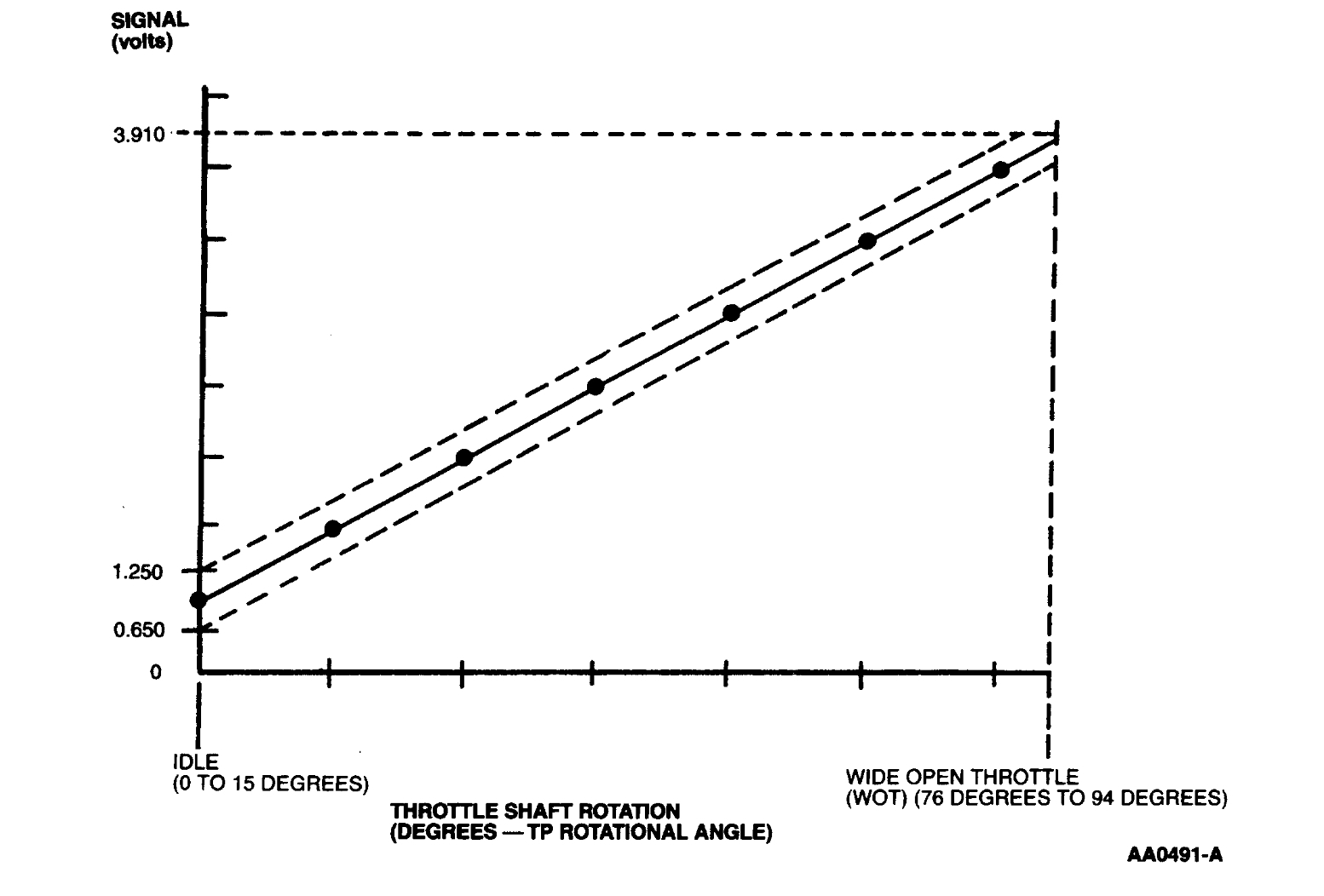

Hi, I have recently purchased this car a couple weeks ago and have noticed that it idles extremely high, and when shifting the rpms hang at about 3 grand. This is annoying because you have to shift really slow, cause the car jerks pretty bad if you dont. I have already checked for vaccum leaks and pulled the IAC off and cleaned it with no succes. I have heard about making a new gasket with a smaller hole for less air flow and was thinking about trying that but im kind of a little leery about it. Should I try it, or just buy a new one? Thanks a lot

I had the exact same problem high idle rpm all of it! TPS Throttle Position Sensor! Make sure to take the screws out carefully and pay attention to which direction the spring loaded sensor turns! Installing the new one you preload the sensor spring exact opposite of removal!

Hey NICK18,
A quick test for your TPS if you can get access to a scanner with live data is to check what the ECM is seeing from the TPS.
You should see a signal around 1V at idle to around 4V at wide open throttle.
If you open and close the throttle you should see a smooth trace from 1V to 4V and back to 1V.
Quickly rules out the TPS and TPS wiring.
