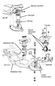

HI. WHen I am pulling out or every one in a while Changing gears at lower speeds I get a loud pop from my Drivers Side Front Wheel area!!! \
I replaced the Strut thinking it was related but did not help. Any Ideas? Thanks

Was strut mount bearing replaced? Ball joint checked ? Lower control arm bushing checked?

Yes The Control arm bushings, Ball joint were both replaced. I am thinking it may be coming from my tie rod, inner or outer.
The strut mount was in good shape too.

Check out sway bar and links look for rubber mounts missing
https://images.2carpros.com/forum/automotive_pictures/198357_Graphic_634.jpg
Also see if spring insulator is deteriated

Sorry but all is in good condition except for there is a single split in the sway bar bushing. The one that is the stabilizer sits in (Mounted to) Not the link
