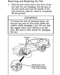

I don't have a manual for the '95 Mustang GT I'm working on. Can someone tell me where I can put the jack under the rear of the car to safely jack it up?

The above info came from a 96 manual, the 95 may be similar. It went on to say, not to put the jack under the pumkin. Be safe.
