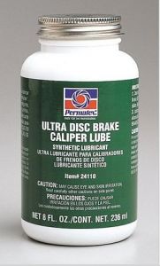

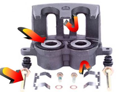

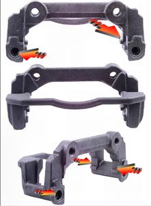

Sounds like the pads are not returning back away from the rotor. Pull them apart and lube the sliding mechanisms and pad contact points..not the pad surface.
https://images.2carpros.com/forum/automotive_pictures/30961_caliper_lubeareas_15.jpg
https://images.2carpros.com/forum/automotive_pictures/30961_caliper_lube_16.jpg
https://images.2carpros.com/forum/automotive_pictures/30961_caliper_lubeareasbrack_15.jpg
This isn't your caliper, but you get the idea, right? May be the quality of the pad as well.
