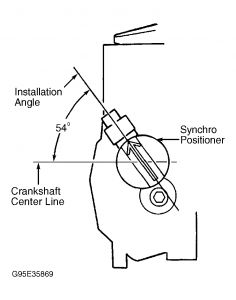

Installation
Install Synchro Positioner (T93P-12200-A) on synchronizer assembly (CMP sensor removed). Turn synchronizer shaft clockwise until tool boss engages with notch in synchronizer housing. Tool should fit squarely in top of synchronizer housing.
Install intermediate shaft in synchronizer assembly. Insert synchronizer assembly. Arrow on synchro positioner should point as indicated in illustration.
Install and tighten hold-down clamp. If synchro positioner is not pointing in correct to correct position, remove synchronizer and start again from step 1). If installed correctly, remove synchro positioner.
Install CMP sensor and tighten screws to specification. Connect CMP sensor harness connector and negative battery cable.
