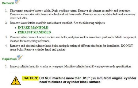

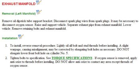

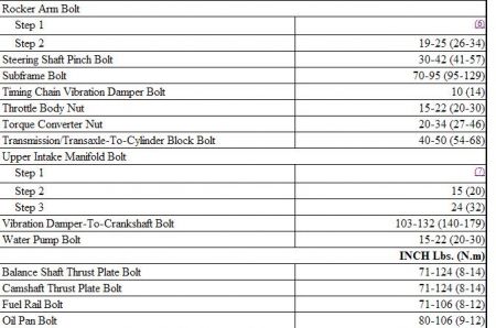

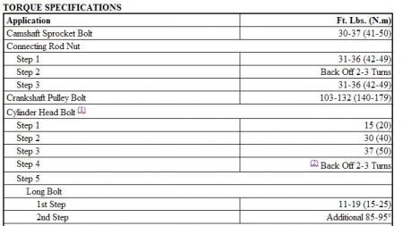

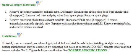

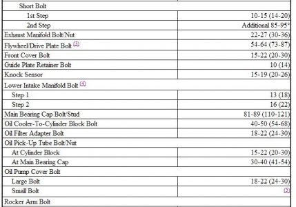

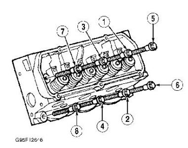

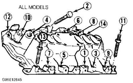

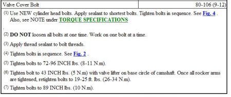

What is the best method of putting a head gasket on?
Saturday, January 17th, 2009 AT 11:03 PM
14 Replies
BLUELIGHTNIN6
  • 16,542 POSTS
Hello

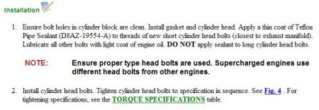

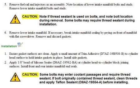

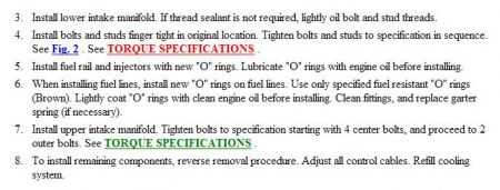

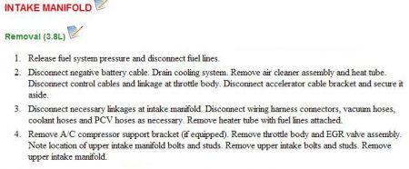

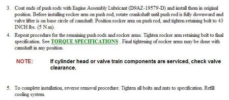

Remove the head by doing the following to replace gasket.
https://www.2carpros.com/forum/automotive_pictures/261618_Noname_164.jpg
https://www.2carpros.com/forum/automotive_pictures/261618_Noname2_57.jpg
https://www.2carpros.com/forum/automotive_pictures/261618_Noname3_28.jpg
https://www.2carpros.com/forum/automotive_pictures/261618_Noname4_16.jpg
https://www.2carpros.com/forum/automotive_pictures/261618_Noname5_8.jpg
https://www.2carpros.com/forum/automotive_pictures/261618_Noname6_4.jpg
https://www.2carpros.com/forum/automotive_pictures/261618_Noname7_1.jpg
https://www.2carpros.com/forum/automotive_pictures/261618_Noname8_1.jpg
https://www.2carpros.com/forum/automotive_pictures/261618_spec_3.jpg
https://www.2carpros.com/forum/automotive_pictures/261618_spec2_4.jpg
https://www.2carpros.com/forum/automotive_pictures/261618_spec3_1.jpg
https://www.2carpros.com/forum/automotive_pictures/261618_spec4_1.jpg
FIGURE 2
https://www.2carpros.com/forum/automotive_pictures/261618_fig2_4.jpg
FIGURE 4
https://www.2carpros.com/forum/automotive_pictures/261618_fig4_5.jpg
