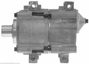

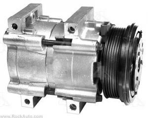

Ok, i'm thinking about getting a 94 Mustang with bad AC. According to the guy, it quit last year. And I have a 96 Windstar, which has great AC, but has a bad headgasket. And it just sits now. Would it be possible if I could take parts off the windstar onto the mustang. Or if they wouldn't fit, as far as the compressor?

There are two types in the windstar that's the bottom one the top is used in both, match em up top is the common FS10, bottom is the delco not used on mustang...
