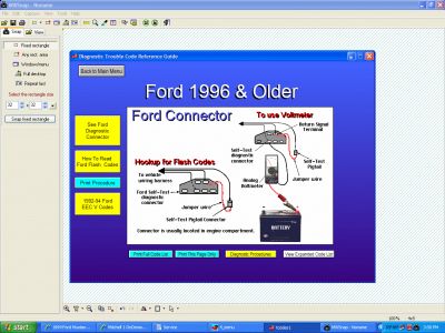

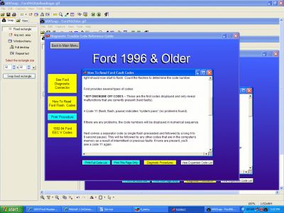

Is your check engine light on? May be worth the trouble to read the stored codes, a bit more info too, like does it restart? right away? Rough idle? Last tune up was? Fuel filter?
