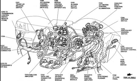

where do i locate the hazard light relay

1994 Ford Mustang V6-232 3.8L Component Locations - Instrument Panel
https://images.2carpros.com/forum/automotive_pictures/12900_hl_1.jpg
The Electronic Flasher is located behind the instrument panel, on the rear of the instrument panel fuse panel.
