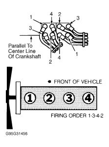

1993 Ford Mustang fireing order(2.3L dis system
1993 FORD MUSTANG
90,000 MILES • 4 CYL • 2WD • MANUAL
RUSSELLHULST
i purchased a1993 mustang which was messed up in the ign system,i need to know what the proper fireing order is for each coil pack? thank you russ.I am a disabled vet and dont have much extra income ,thanks

BMRFIXIT
  • 19,053 POSTS
THANK YOU 1342
https://images.2carpros.com/forum/automotive_pictures/99387_Graphic1_87.jpg
