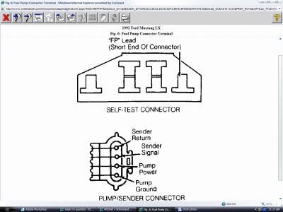

No power at injectors? Check the injector fuse, but a bad pick up can cause it. If you dont hear the pump, test the pump like this.
https://images.2carpros.com/forum/automotive_pictures/62217_FP_Test_1.jpg
Grouind the FP and see if the pump runs...

My husband put a wire tester to the injector wires and "shorted" them and they sprayed. We do have fuel pressure to the rail. does is still sound like a bad pick up coil? Thanks.

If the pickup is bad you will not have spark at the plugs, do you? Did he test the pump as I outlined?

yes the pump is working properly and we have spark. What else could it be?

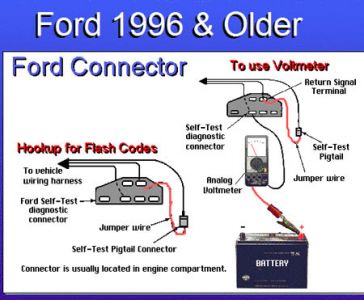

Do this and count the flashes...Count the flashes, a 22 will flash as 2 flashes then a short pause, then 2 flashes, if more than one code is stored, the pause will be longer. The codes will display three times and end with 11 or 111. Write them down and post here. First do this with the ke on engine off, then again with it running.
