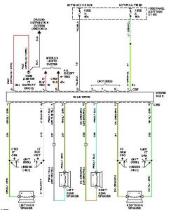

I need a wiring diagram for my radio.. I have tried to install a newer one but the wire colors don't match. Can you help me?

Wiring below is for the Base radio system. If your vehicle is equipped with the Premium radio system let me know.. If your vehicle is equipped with a factory amplifier you will need to bypass it to get the aftermarket radio to work properly..
https://images.2carpros.com/forum/automotive_pictures/261618_Noname_342.jpg
Too small, can't read it? Give me email addy and I will send it via email so you can zoom in on it. Thanks for using 2CarPros.com !
