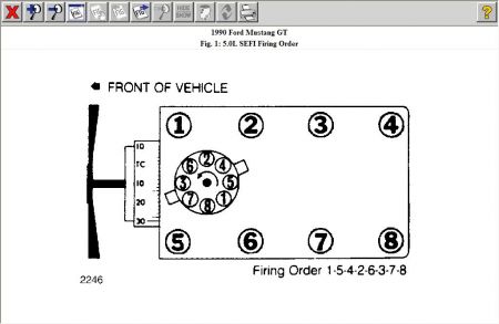

I need to know the firing order plus the location of where the wires shud be on my distributor cap...

See below
https://images.2carpros.com/forum/automotive_pictures/12900_302_1.jpg
