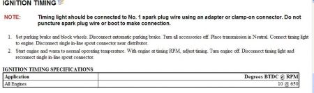

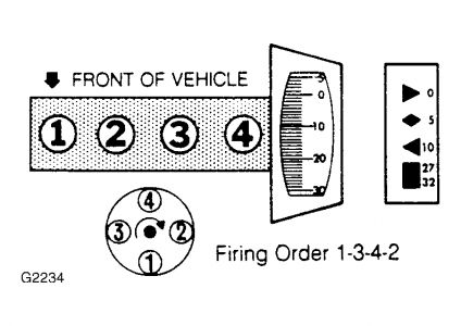

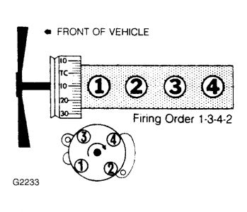

What is the timing and firing order for this car?
Aug 30, 2008 at 10:22 AM
MHPAUTOS
  • 31,937 POSTS
Hi there, timing & firing order for both front & rear wheel drive versions. Mark (mhpautos)
