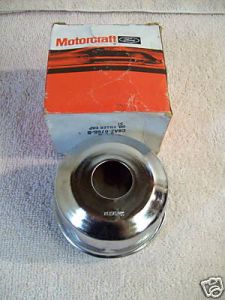

Now what I would do if the valve cover allows is use the ford oil cap that has the hole in top with the rubber grommets that way you can put the pcv in that and then just find a way to put a breather in the other so you can hook a hose to the bottom or side of the air cleaner. The first pic is of the oil cap with hole that comes with groumet to put a pcv valve in and the second pic is of the breather with the tube so you can connect it to the air cleaner somewhere. Hope this helps. Thanks again.
https://images.2carpros.com/forum/automotive_pictures/249564_BTYzTgCGkKGrHgoHCQEkJwwr3WBKINFS5Ng_1_1.jpg
https://images.2carpros.com/forum/automotive_pictures/249564_images_2.jpg
