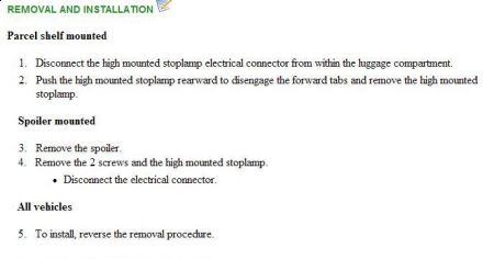

2007 Ford Fusion UPPER REAR BRAKE LIGHT BULB REPLACEMENT
2007 FORD FUSION
RICHARD.B
Electrical problem
2007 Ford Fusion 4 cyl Two Wheel Drive Manual
Is there an easy way to remove the upper rear brake
light so i can replace the bulb.

https://images.2carpros.com/forum/automotive_pictures/261618_Noname_397.jpg
