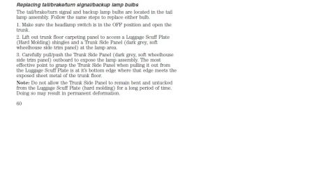

How do I replace a left rear signal light on a 2007 ford fusion

Thanks for the donation. Do you have an owners manual? If not, www.fordparts.com has online owners manuals you can look at. When the site comes up, click on the pro link at the top, then in the left column is a link for owners guides.
https://images.2carpros.com/forum/automotive_pictures/512072_focus_lamps_1_1.jpg
https://images.2carpros.com/forum/automotive_pictures/512072_focus_lamps_2_1.jpg
