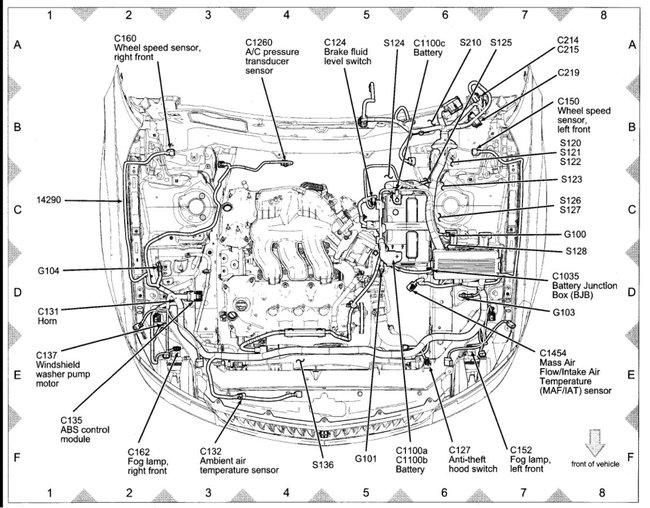

My ambient air temperature sensor is bad and i need to locate it in order to replace it
May 8, 2010 at 2:18 PM
  • 55,423 POSTS
the ambient air temperature sensor is located at the front the the car near the grill. Here is a diagram of its location (below) c132.

need to change ambient air temperature sensor but cant seem to find it can you tell me where it is at and if there is more than one in the vehicle?
Oct 23, 2018 at 11:16 AM (Merged)
BLUELIGHTNIN6
  • 16,542 POSTS

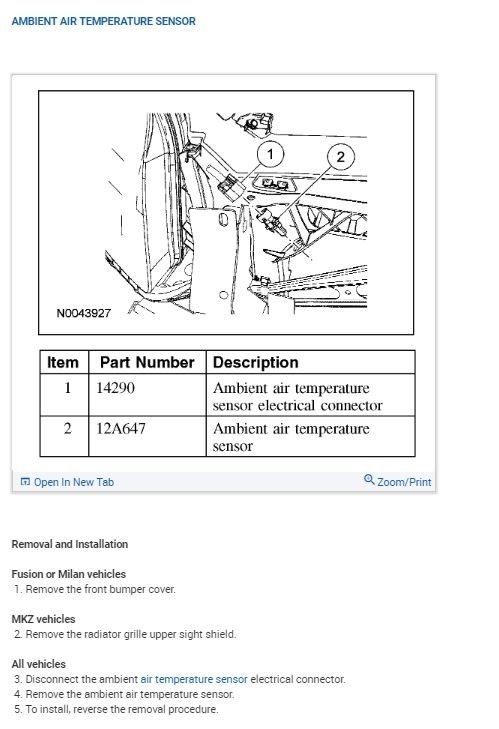

ambient air temp. sensor on the 2.3L engine is at the right side of the radiator support
See the attached instructions for replacing the sensor
