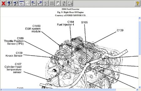

HELLO! I HAVE AN ENGINE PING ALSO. I TRIED STP, HIGH OCTANE GAS, ETC WITH NO RESULTS. MINE PINGS MUCH MORE WHEN THE AC IS ON AND THE ENGINE IS WARMED UP. IT EVEN PINGS AT A STOP LIGHT WHEN THE AC FAN KICKS IN. CAN YOU TELL ME IF THIS HAS A KNOCK SENSOR, EGR, AND IF THE OCTAIN BAR REMOVAL WOULD BE BEST? THANKS

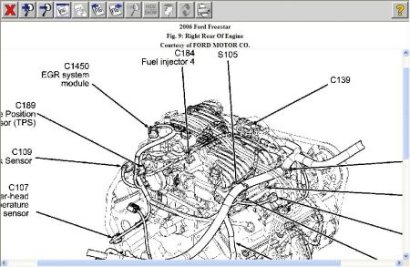

EGR and KS location a problem with this 2 will cause the engine to detonate/ping see below
https://images.2carpros.com/forum/automotive_pictures/12900_EGR_module_1.jpg
https://images.2carpros.com/forum/automotive_pictures/12900_kS_1.jpg
