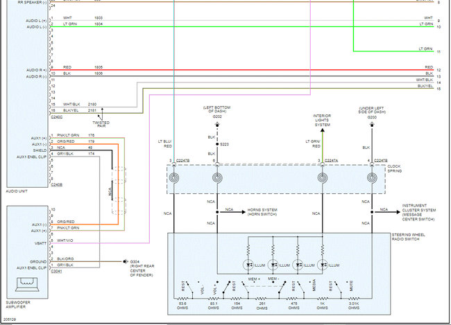

Vehicle has CD unit w/ AUX selector. Currently the factory DVD player is the input for the AUX. What I want to do is splice in an additional input into the input wires for the AUX. I intend to add a stereo port that I plug in my iPod into the stereo.
The wiring diagram is from a shaker model. I think that is a a amp addon and uses the J4 connector. Mine only has the J1 & J3 connectors. I think the pinouts are the same on all of these connectors.
My main concern would be not blowing the stereo because two units are inputting to the AUX. I don't plan on playing the DVD player and iPod and the same time but...... I doubt the combined power of the two units would do any damage but tolerances of today's electronics are the same as in the 80's so I thought I'd ask.

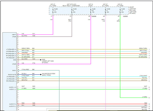

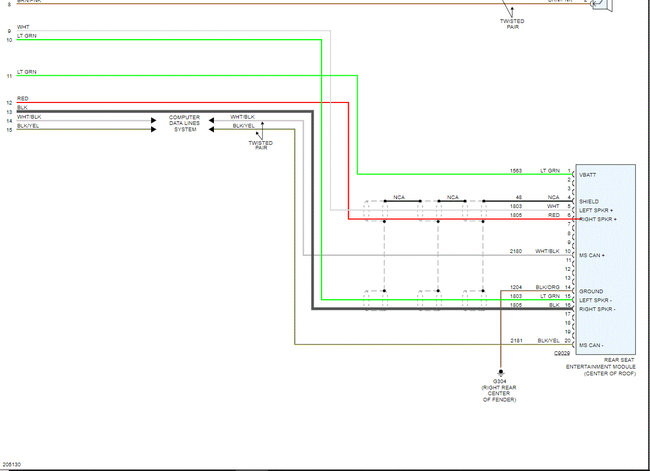

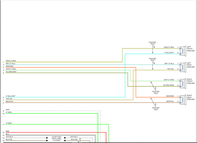

As far as the wiring schematics, note there is an Aux + and Aux - when you are doing the work. I'm not completely sure I understand what you are trying to do, but I attached the wiring schematics below for your review.
Note, I had to cut each of the two pics in half to make them readable for you. However, I did overlap them so you can follow from one to the next.
Here is a link you may find helpful when working with wiring and connections:
See pics attached.
