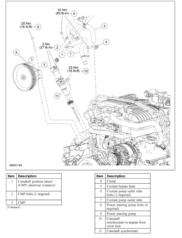

error code stated cam position sensor, replaced sensor but the problem still there, no other codes given still getting. sensor code. engine seems to run fine until you go above 2000 rpms and it stalls and the belt squeals, what are the other possible problems to cause this condition? this is my sister in-law's vehicle and trying to get it fixed.

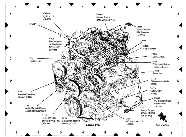

Let's replace the camshaft sensor (CMP synchronisation) which if is shorts out can cause the engine to stall. This guide will walk you through the steps with the location of the sensor featured in the diagrams below.
https://www.2carpros.com/articles/camshaft-angle-sensor-replacement
Was the alternator ever replaced? Seems there were many cases of faulty alternators causing the problem.
Check out the diagrams (Below). Please let us know what you find. We are interested to see what it is.

i believe the alternator was replaced in the past year, the engine is the 3.9L one thing i forgot to mention- unsure if it makes a difference- when i replaced the cam sensor made no difference so i took it off again cleaned the contacts of the connectors and cleaned with electrical contact cleaner where the sensor itself goes and reassembled it. And for about 1 minute thought that fixed it- ran above 2000 rpm to about 4000 rpm then it started stalling there then started stalling again just above 2000 rpm, she also just had the power steering pump replaced belt tensioner and belt

Since alternator was replaced before, I would suggest checking it first. Many technicians all over had encuntered a fault with the alternator trigggering P0340.
