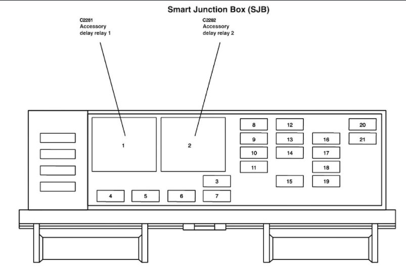

lights are not working fuse panel needed
2005 FORD FREESTAR
ZOODLE21

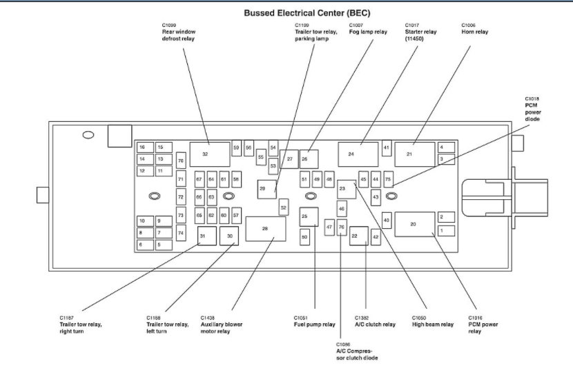

We just replaced our air filter before making our highway trip. Upon returning home we noticed that our lights are not working where are the fuses and how do I check them?

Here is the information you requested. Here are a few tutorials for you to view on how to check and replace fuses:

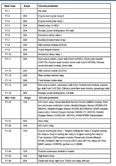

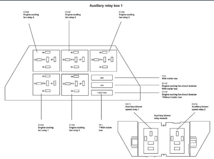

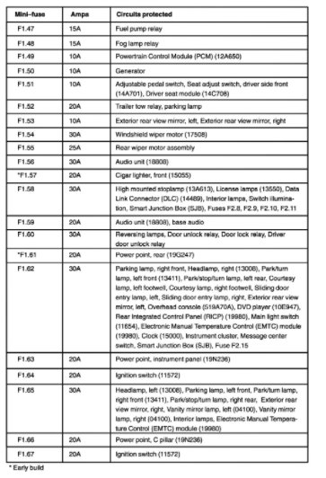

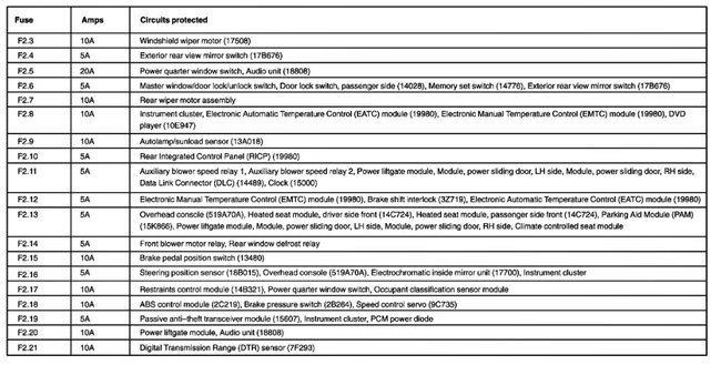

I've attached pictures below showing the fuse and relay locations on your vehicle. Hope this helps and thanks for using 2CarPros.
