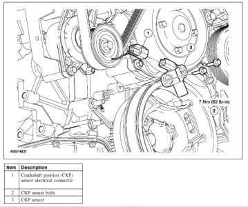

How change crankshaft angle sensor
Mar 25, 2010 at 5:27 AM
  • 75,992 POSTS
CRANKSHAFT POSITION (CKP) SENSOR REMOVAL 1.With the vehicle in NEUTRAL, position it on a hoist. 2.Disconnect the battery ground cable.
https://images.2carpros.com/forum/automotive_pictures/12900_cs_7.jpg
3.Remove the parts in the order indicated in the illustration and table. INSTALLATION 1.To install, reverse the removal procedure. https://www.2carpros.com/kpages/auto_repair_manuals_alldata.htm
