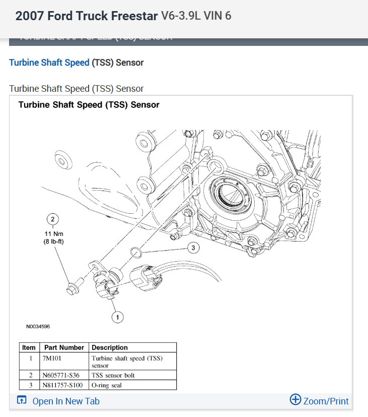

I have gotten a code of P0732, which my car won’t go to second gear it stays in first gear, only goes 25-30 MPH, I have checked the transmission fluid, and it was at its level, and it was clean.
Dec 17, 2024 at 5:16 AM
  • 54,832 POSTS
So this can be that 2nd gear is burnt up or you have a weak turbine shaft speed sensor.
P0732 - Gear 2 Incorrect Ratio This code means the transmission control module (TCM) has detected that the ratio of input speed to output speed does not match the expected ratio for 2nd gear.
Here is the location of the sensor so you can swap it out. Check out the images (below). Please let us know what happens.

I’ve have changed that sensor and it’s still does the same thing, it won’t change gears.
Dec 21, 2024 at 2:11 PM
  • 54,832 POSTS
Hmm, how is the transmission fluid can you tell if it is burnt or not? You may have a bad transmission and it needs to be replaced. After replacing the sensor did you clear the codes?
