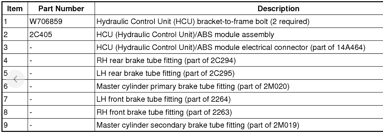

I have an ABS module for Ford Focus 2012, can i use it for the car listed above?
Mar 12, 2019 at 8:17 PM
  • 55,694 POSTS

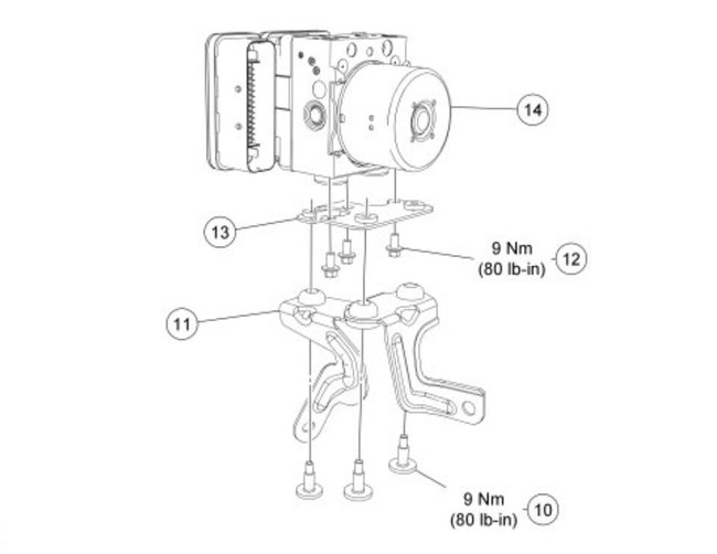

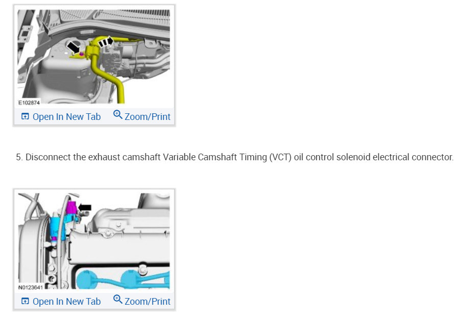

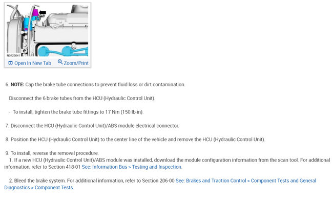

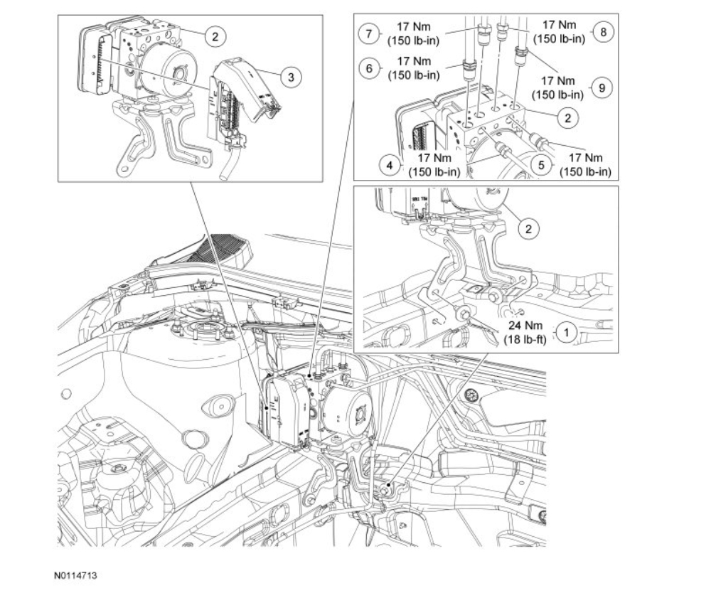

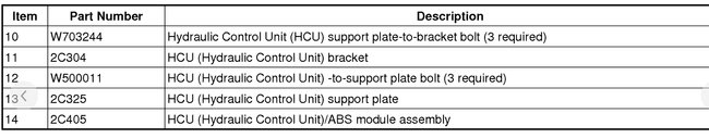

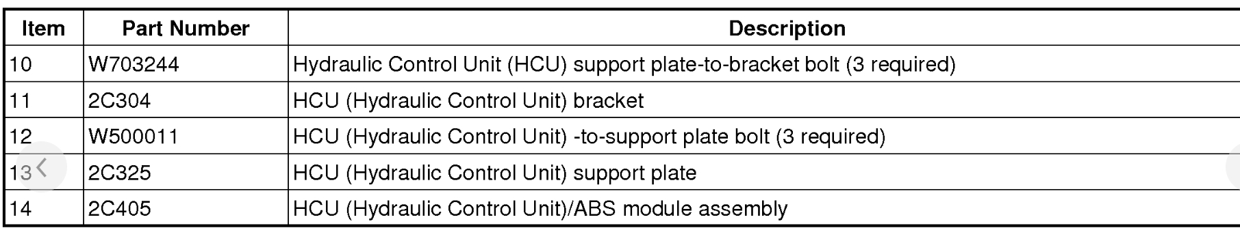

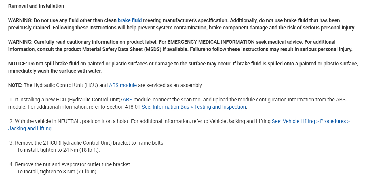

Yes, they should work please upload the part numbers of both units so I can check to be sure. here are the instructions and diagrams on how to change the ABS unit out. Check out the diagrams (below). Please let us know if you need anything else to get the problem fixed.
Mar 14, 2019 at 6:20 AM

The PN for focus is BV61-2C405-AG and the PN for fiesta is AV59-2C405-EA.
I have tried to install the ABS module on my car in Ford service center but the it cannot synchronized.
Advise please?
Thanks,
Galang
Mar 14, 2019 at 11:04 AM
  • 55,694 POSTS
Yes, the modules are not interchangeable, you will need the correct unit. Please let us know what happens.
