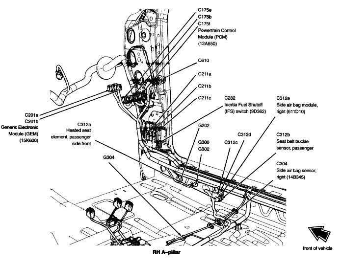

I have a new gem module does it need programming to the car or is it plug and play? Where do I locate the gem on a right hand drive?

Yes, it will need to be programmed to your vehicle.The module is mounted to the right hand A-pillar. I've attached a picture below of its location and description.Hope this helps and thanks for using 2CarPros.
