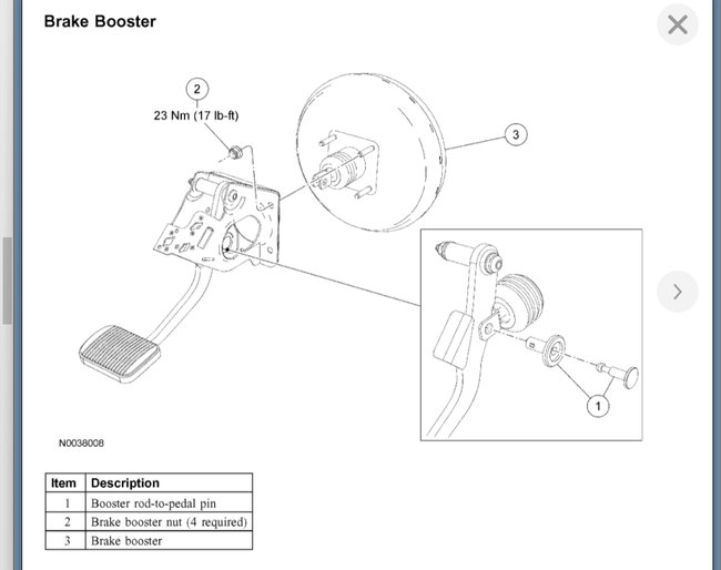

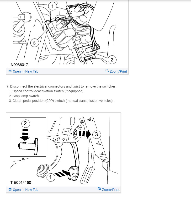

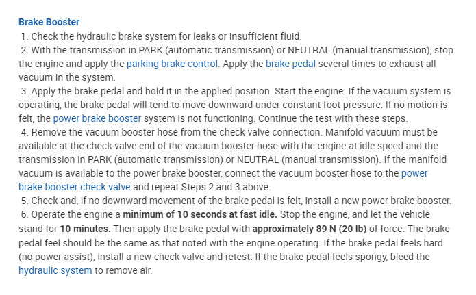

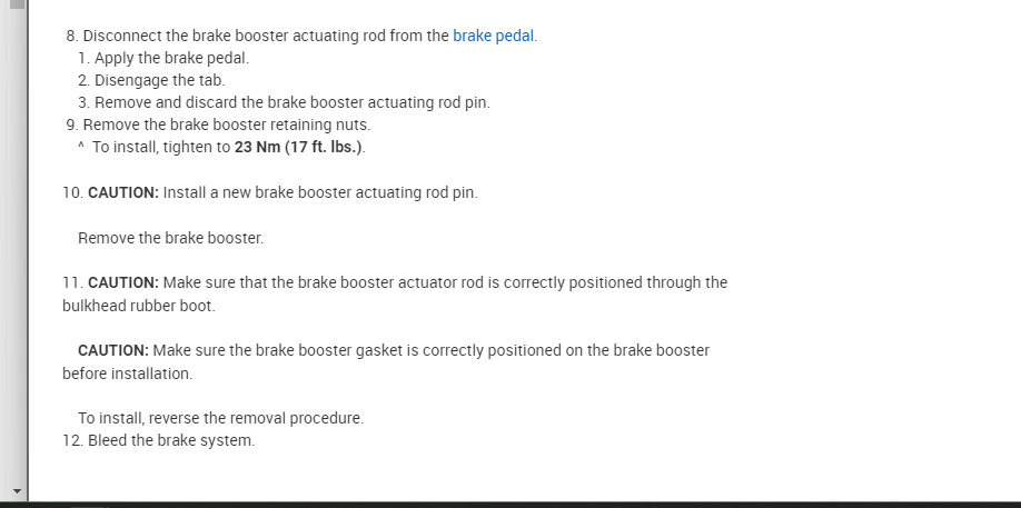

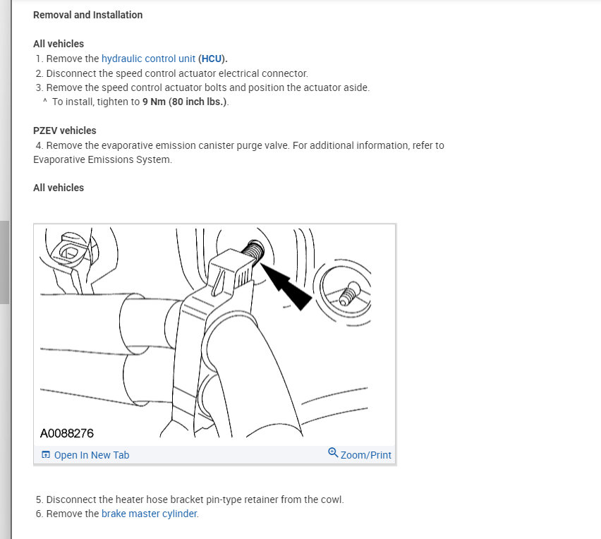

More than likely you have an issue with the brake booster. So, we need to start with testing this and go from there.
I am attaching the info below from the manual on how to test this.
However, we should also check the vacuum line from the engine for leaks or cracks.
Here is a guide that will help with this.
Please find the attached info on how to test the booster and let us know what you find with this.

That is interesting. However, I am concerned that this did not permanently repair the issue. More than likely by turning the rod in you increased the pedal travel and that may be causing the booster to seal, but I don't think it will be a long-term solution.
If it were me and this made an improvement, I would go ahead and replace the booster.
