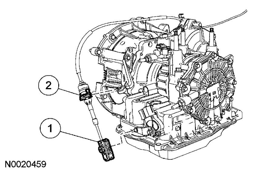

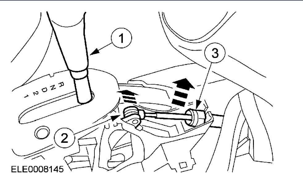

ZXW model. Car is in neutral or reverse. Can't tell at the moment. Gear shift will go from park to first gear position, but does not engage. Feels like selector cable is disengaged or broken.

Can you include diagrams?
I know how to remove the center console.
Not sure i could do the cable path through the engine compartment.
Depends on how much I'd have to remove.
I looked under the hood and found what i believe to be
that rectangle clasp thing that I think attaches to the transmission.
It looks a bit off. Can't reach it and I have an uneven dirt driveway
so I'm not even sure i can crawl under it to see if it became detached.
Please let me know your thoughts.

Got it.
It does sound like the cable.
I attached pictures of the cable.
You need to open the console. The rest is done under the hood.
