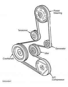

2004 Ford Focus 4 cyl Two Wheel Drive Automatic
I need a diagram for the above car as it has spun the old belt off and I cannot get it to fit back
it is a multirib belt
May 5, 2010 at 4:33 PM
BLUELIGHTNIN6
  • 16,542 POSTS
routing for the 2.0L SPI with A/C is below.. if you have other model (i.e 2.0L Zetec-E) then let me know
