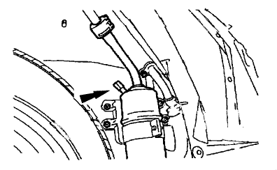

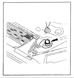

Hi there!!!
I have check the owner's manual but it never did say where the location of the refrigerant valve inlet is situated to recharge the air conditioning of my wife's car, am very disappointed with this ford focus manual. Pls... help.
Jul 12, 2010 at 6:23 AM
  • 75,988 POSTS
Alldata Editors Note: Ford does not provide locations for the A/C Service Ports. Alldata users have reported these locations to be correct. A/C Service Ports Low Side: Located in passenger side wheel arch.
https://images.2carpros.com/forum/automotive_pictures/12900_s_1.gif
Raise the vehicle. Detach the wheel arch trim panel on the passenger's side (driver's side shown). Remove six bolts. Remove the trim panel.
https://images.2carpros.com/forum/automotive_pictures/12900_s1_5.gif
High Side: Located in engine compartment, drivers side radiator support.
https://images.2carpros.com/forum/automotive_pictures/12900_s2_49.jpg
