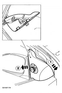

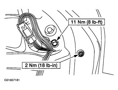

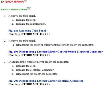

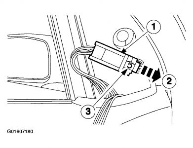

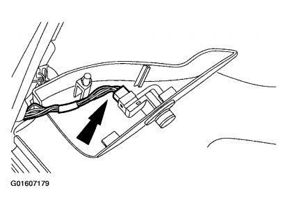

I'm a college student who's car was recently vandalized on campus. passenger side view view was broken off the bracket and is hanging by wires. what is the easiest way for me to remove and replace the mirror
