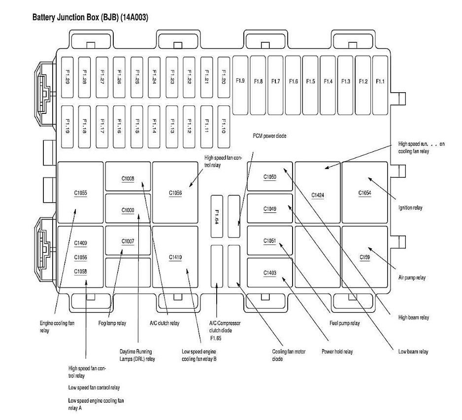

s both low beams quit working at the same time, high beams are still working any clue as to the problem and how to fix it?

check owners manual it will talk about the relays. there will be a couple of relays under the hood. There are two for the headlights. one fir high beam and one for low beam. check to see if you are getting power to the low beam relay. The relay could be bad
Here's a couple guides to help you out
Attached below is a diagram to show you which relay

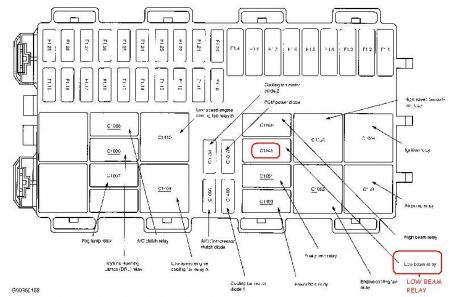

Sounds like a faulty low beam relay. Your low beam relay is located in the battery junction box (see figure below).
https://images.2carpros.com/forum/automotive_pictures/261618_Noname_149.jpg
Click the following link for guidance on testing your relay. Post results and I will continue diagnosis if relay tests good. TESTING RELAY https://www.2carpros.com/how_to/how_do_i_check_a_relay.htm Thanks for using 2CarPros.com !
