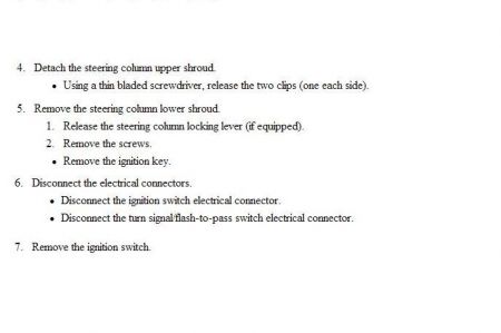

key wont turn.cylinder wont come out.tryed using the punch w\ a lite tap of a hammer. its loose and moves in and out a bit but not all the way.
