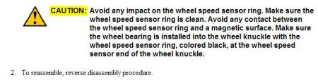

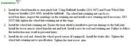

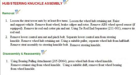

How to change a front wheel bearing on a 2003 ford focus
Thursday, February 25th, 2010 AT 11:01 AM
BLUELIGHTNIN6
MECHANIC
16,542 POSTS
SPONSORED LINKS
Thursday, February 25th, 2010 AT 2:29 PM
