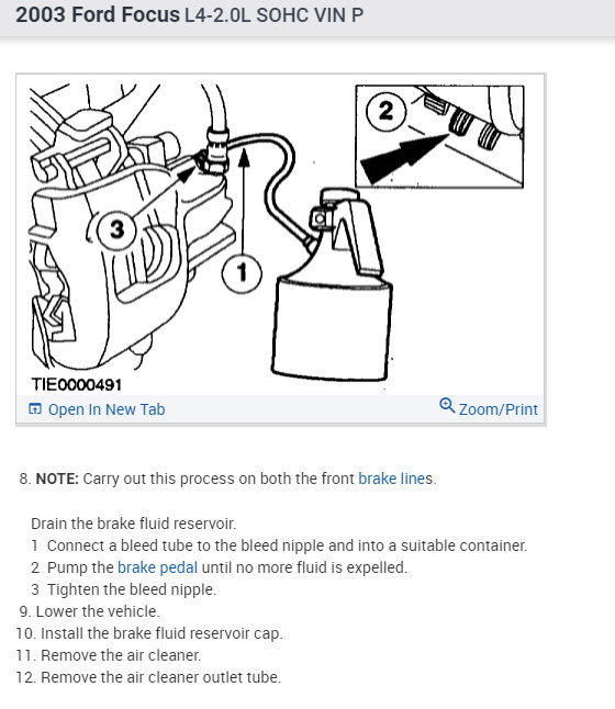

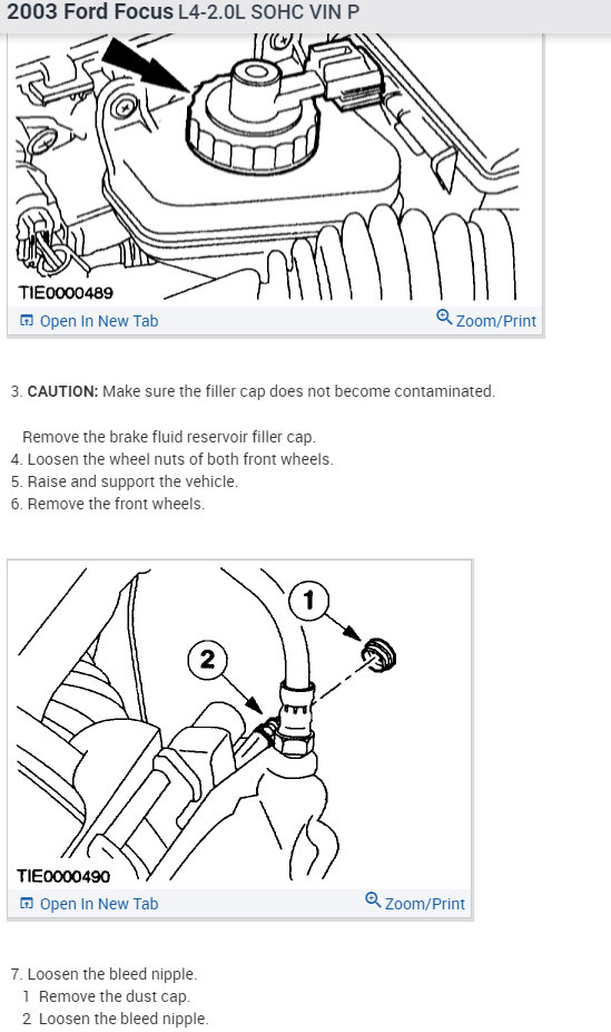

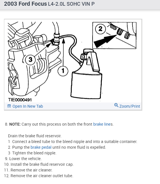

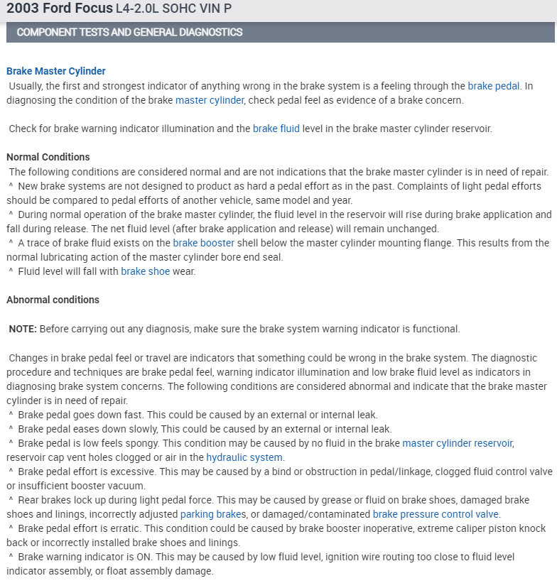

There is a clear liquid leaking from under my car so I fixed the master but don't know how to bleed the system
Mar 23, 2009 at 9:57 PM
BMRFIXIT
  • 19,053 POSTS
Here is a video and guide below to help you bleed the brake system correctly.
https://youtu.be/w7gUsj2us0U
and
https://www.2carpros.com/articles/how-to-bleed-or-flush-a-car-brake-system
and
https://youtu.be/WDxvEQrMkBg
Mar 15, 2021 at 12:21 PM
BRANDY0126656
Thanks for the reply...the video helped me fix it

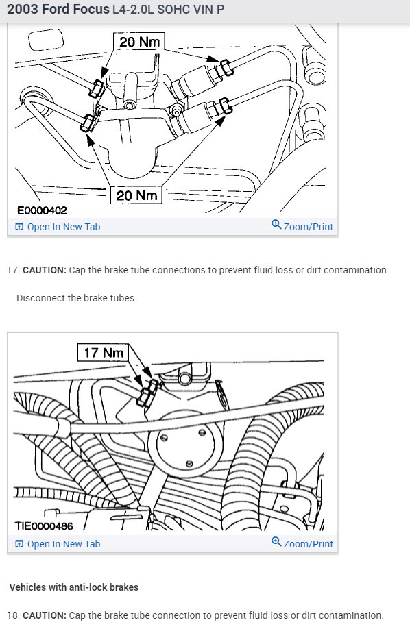

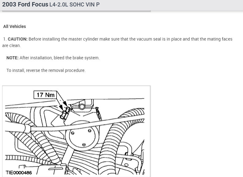

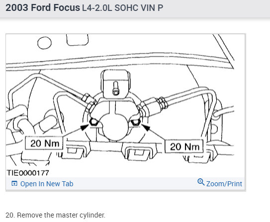

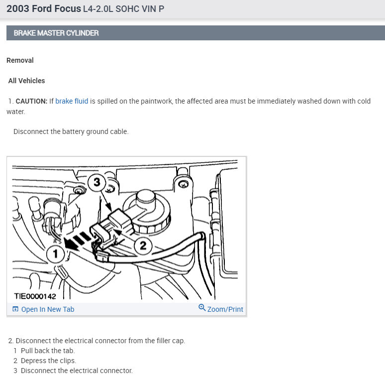

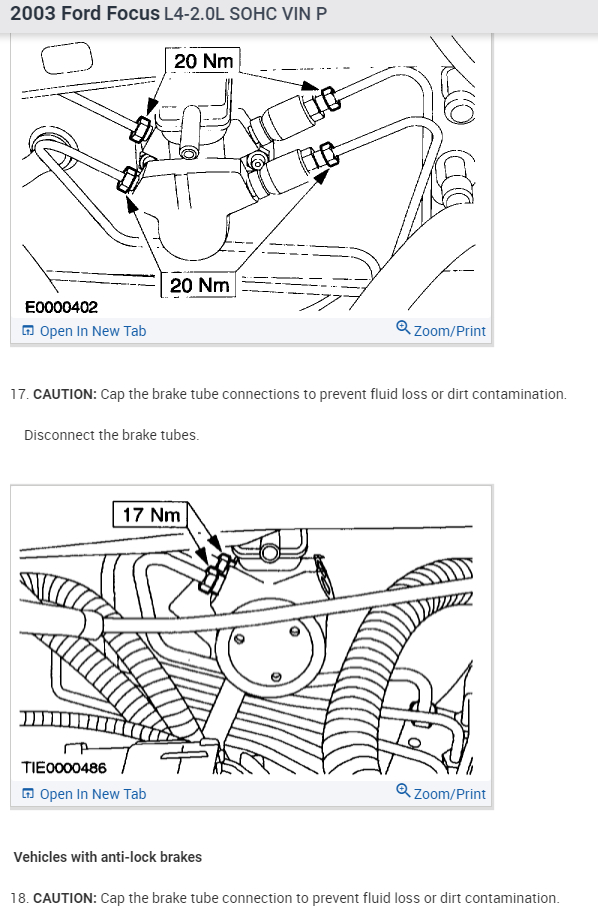

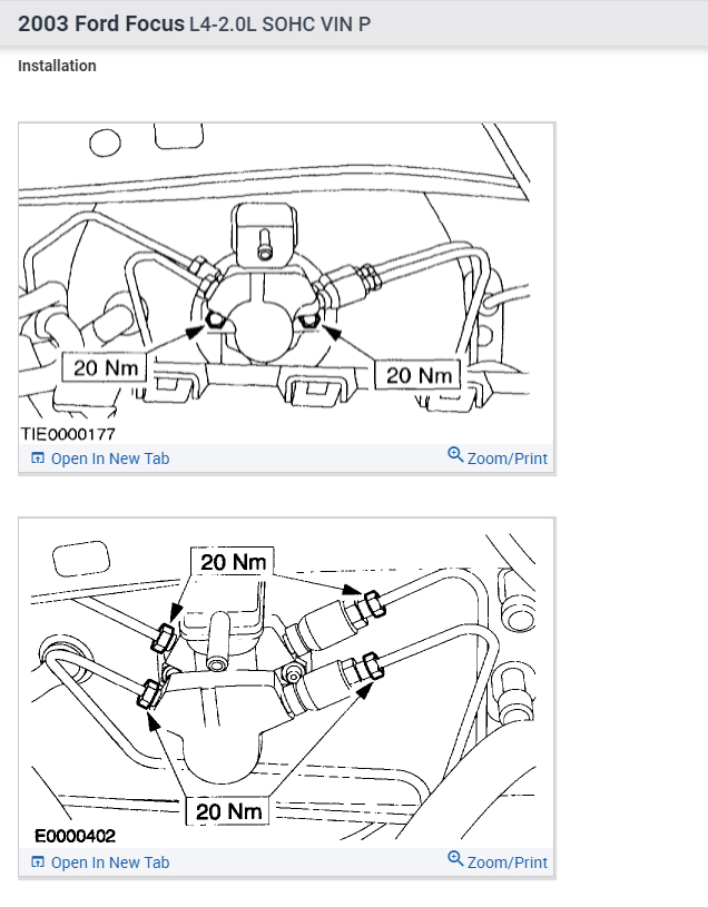

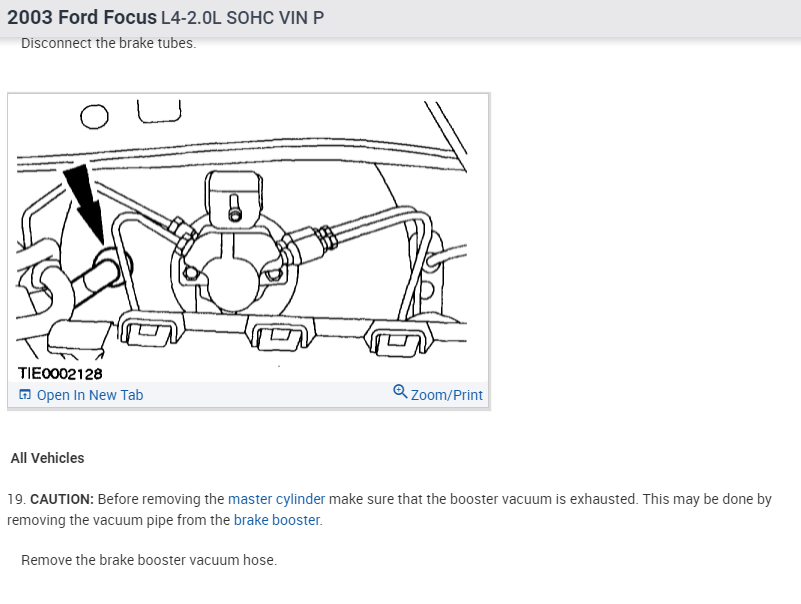

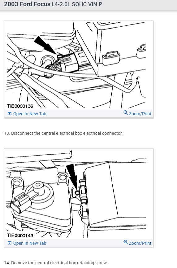

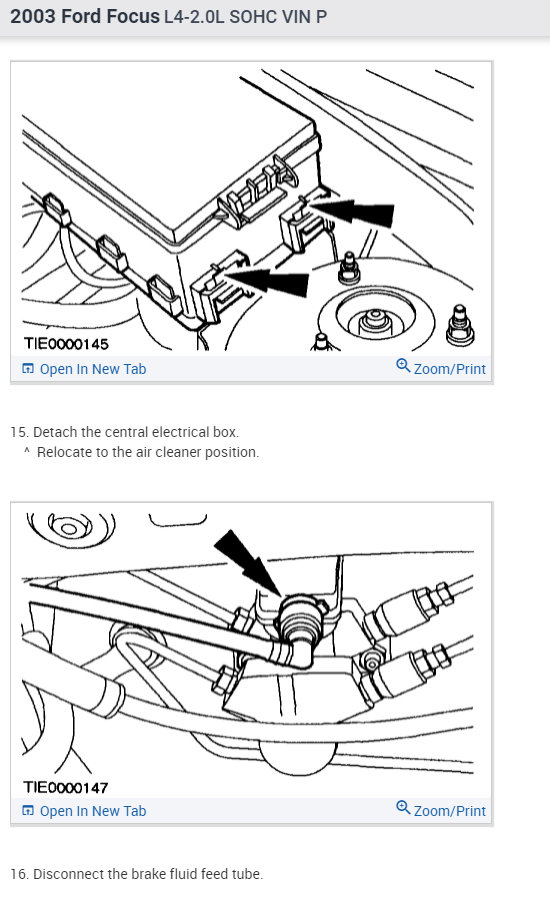

I have attached the master cylinder replacement procedure for anyone else might be looking for vehicle specific instructions.
Let me know of any questions.
https://www.2carpros.com/articles/how-to-replace-a-brake-master-cylinder
