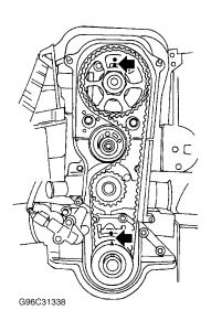

what is the timming mark on a 2.0

Hello and thanks for donating Below is the diagram for aligning the timing marks on the 2.0L SOHC engine.
