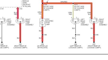

The rear passenger side lights stopped working. When I press the brake pedal the light comes on in the rear screen only. Have checked all the fuses and all seem to be ok.

You probably lost the ground circuit-check the ground point G47-see below
https://images.2carpros.com/forum/automotive_pictures/12900_g47_1.jpg

I find it hard to read this diagram, could you send me a larger version. Thanks, John.

Give me your email addy it supposely work better-that's as far I can get it readable otherwise I'll be seeing the same thing.
