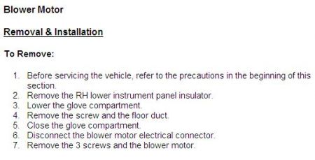

2001 Ford Focus 4 cyl Front Wheel Drive 220,00 miles
where is fan blower motor located and how do you replce it

Welcome to the forum. Your talking about the hvac blower motor? I found the info below.
https://images.2carpros.com/forum/automotive_pictures/170934_focus_blower_motor_1.jpg
